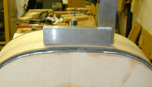

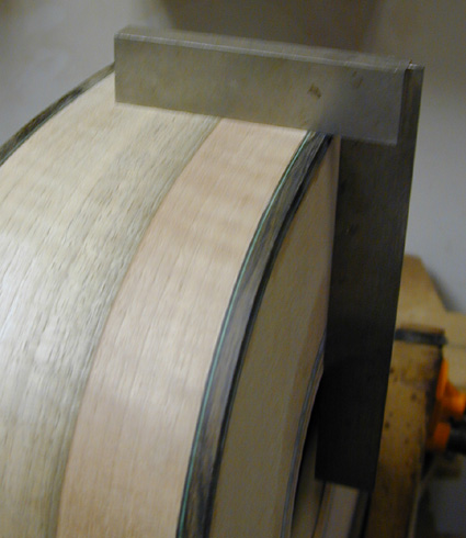

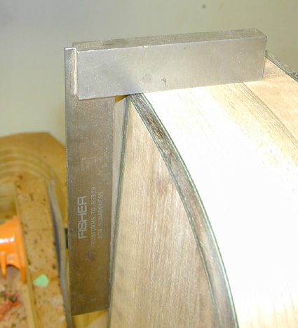

I think I understand what you are saying, Mike - yes the blocks are gulued in flush against the mold, and if the mold were sitting on hte owrkbench then the blcok wold be 90 degrees to the bench assuming the side of the mold is indeed square as well. That said, if it is or isnt really doesnt matter. The neck heel will be sitting fully inide the area of the side upon which the neck block has been glued correct ?? If this happens t be 88 or 92 degrees to the bench, it jsut means you have ot cut the neck heel at a different angle to get it so seat flush against the side. Here are a coupl pix of a recent student build, showing the neck area to top and back angles. Now if you cut your neck angles previsouly to having the gutiars bodya t this stage, you may be asking for trouble, if indeed you have had something slip/move during glue up. Using the pic of the top2side angle, I take a sliding bevel gauge and set it to be flush on both surfaces. Now take the bevel gauge to the table saw, and under cut the angle on the neck blank a hair, in order to give you some leeway in setting the back angle, the side to side centre line fit, and getting the heel to fit tight to the sides in general.
PostPosted: Mon Jul 03, 2006 1:50 am
Here is a pic of the same guitar, showing the curve at the heel area of the sides - the heel will be sanded using the pull sandpaper technique to match the flat cut off the tablesaw to this curve.
For those who might ask, this is a curly french walnut and sitka pseudo-dread, bound in ziricote, top purf is green/blk/red ab/blk and the side and back purf is blk/green.TonyKarol38901.4530902778
